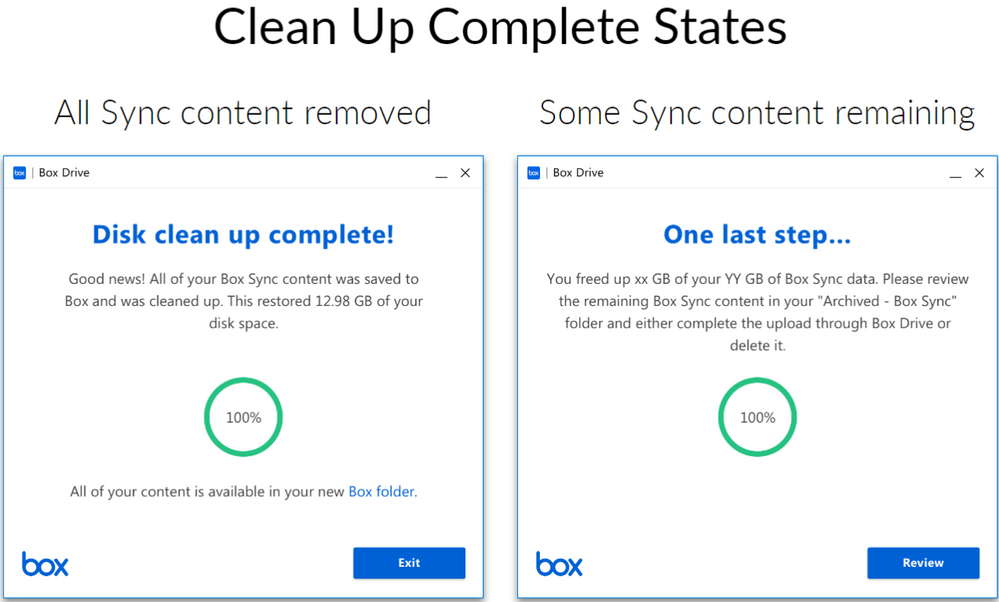

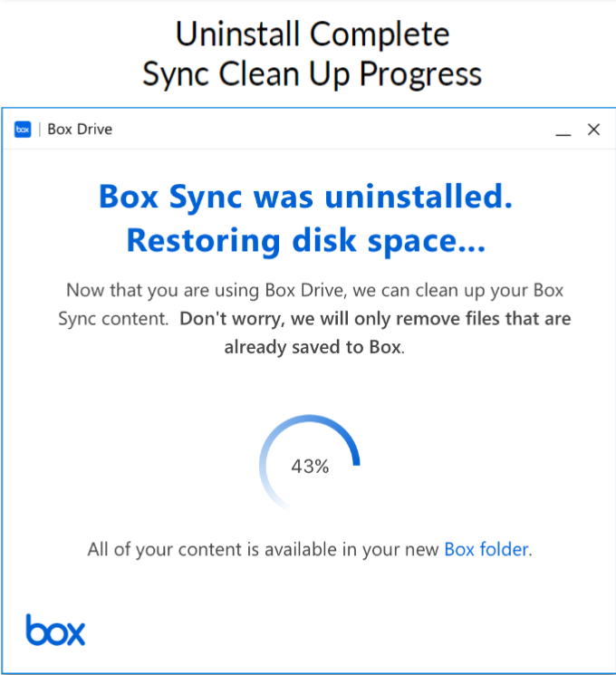

Handle the Cleanup Process
- After uninstall, Box Drive will clean up “up-to-date” Box Sync files (i.e., files that were synced to Box).
- Non-synchronized items (those not uploaded to Box) are not deleted. They are placed into a folder called “Archived – Box Sync” so you (or your users) can review them.

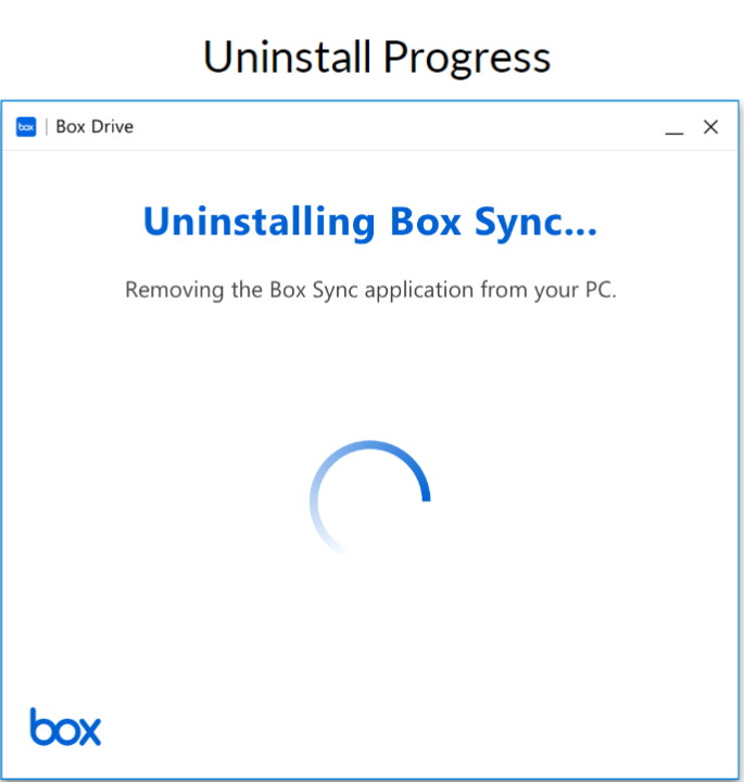

End user uninstall walkthrough
Here are the system prompts. If you choose to change the default uninstallation process (details later in this article) you may not see every prompt:
You can decline the Sync uninstallation by closing the prompt. However, each successive time you start Box Drive the system prompts you to uninstall Sync, until you agree to the uninstallation. If an uninstallation is interrupted (for example, if there were errors, if you quit Drive in the midst of the uninstallation, and so on), Drive automatically resumes the process the next time you start Drive.

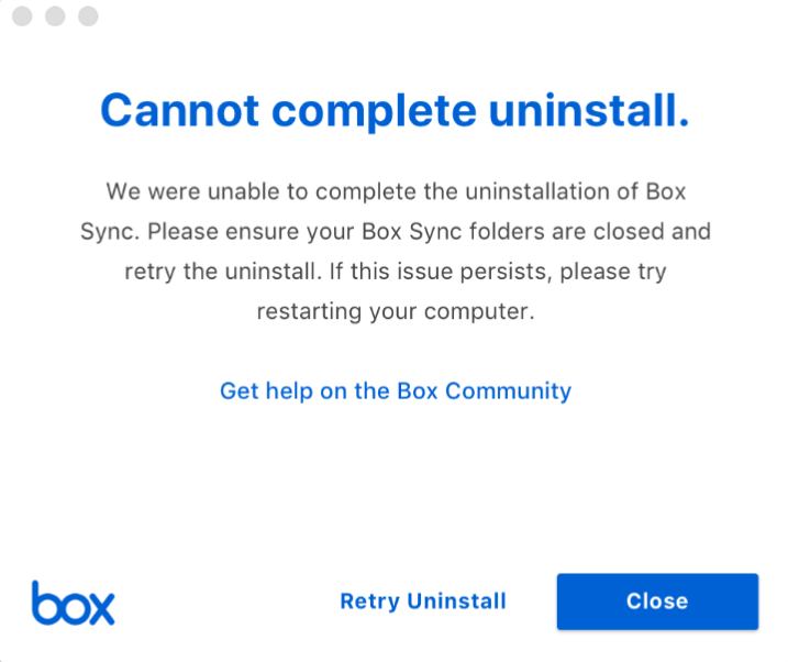

Failure to uninstall
On rare occasions Box Drive is unable to prepare the Box Sync folder for cleanup. Usually this is because a Box Sync file or folder is still open when the cleanup initiates.
If you see this error message, ensure the person has closed all files and folders. Then retry the uninstallation. If the uninstallation still fails, try restarting the machine. Box Drive attempts to resume the uninstallation the next time Drive launches after the machine restarts. If it succeeds, it progresses right into cleanup. If it does not succeed, it re-displays the error message. Please open a support ticket if this happens.
