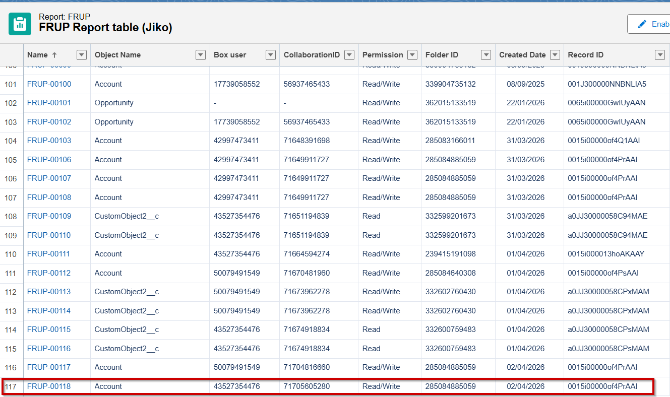

FRUP rows for a user and record(s):
SELECT Name,
box__Box_user__c,
box__CollaborationID__c,
box__Folder_ID__c,
box__Object_Name__c,
box__Permission__c,
box__Record_ID_Indexed__c,
box__Salesforce_User__c,
box__BOSS_Action__c,
box__BOSS_Status__c,
box__Retry_Count__c
FROM box__Frup__c
WHERE box__Record_ID_Indexed__c IN ('001xxxxxxxxxxxxxx', 'a0Jxxxxxxxxxxxxxx')
AND box__Salesforce_User__c = '005xxxxxxxxxxxxxx'Sample output:
| Name | box__Box_user__c | box__CollaborationID__c | box__Folder_ID__c | box__Object_Name__c | box__Permission__c | box__Record_ID_Indexed__c | box__Salesforce_User__c |
| FRUP-00118 | 43527354476 | 71705605280 | 285084885059 | Account | Read/Write | 0015i00000of4PrAAI | 0055i00000BFCllAAH |
| FRUP-00111 | 43527354476 | 71664594274 | 239415191098 | Account | Read/Write | 0015i000013hoAKAAY | 0055i00000BFCllAAH |
| FRUP-00115 | 43527354476 | 71674918834 | 332600759483 | CustomObject2__c | Read | a0JJ30000058CPsMAM | 0055i00000BFCllAAH |
If UserRecordAccess and FRUP do not reflect the access you expect, or Box still shows the wrong role, the Salesforce-Box permission mapping is out of sync. Follow Recreate FRUP and collaboration next.

0015i00000of4PrAAI —
HasEditAccess = falseonUserRecordAccessbutbox__Permission__c = Read/Writeonbox__Frup__c: not aligned (read-only in Salesforce, Read/Write on Box).

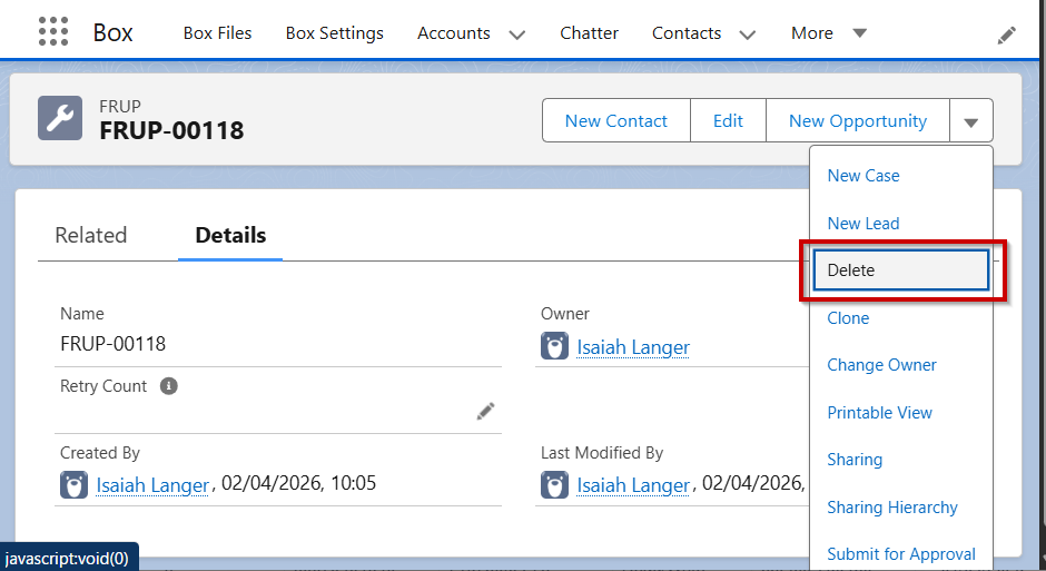

2. Delete the FRUP row(s) in Salesforce
Delete the FRUP record(s) that are out of sync. In the example above, FRUP-00118 is the row that is out of sync and should be deleted.
Open the FRUP record from the FRUP report/object (list view or related list), then Delete.
Deleting FRUP is necessary because Box for Salesforce will keep referencing the FRUP row for collaboration you removed in step 1. This causes error in Box embed/UI elements since the affected user no longer has access to the Box folder tied to that record.
After you delete the FRUP row, when the user next uses Box for Salesforce on that record (i.e. loads the Box embed or UI Elements on the record page), FRUP is recreated and the user is re-invited automatically.
