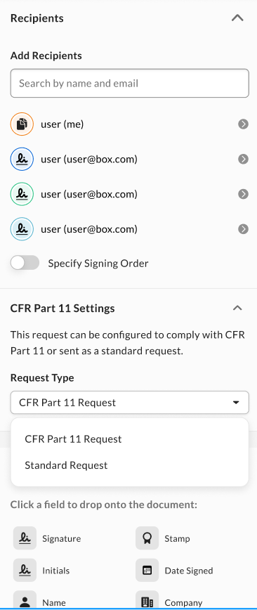

Sending Process
To begin the sending process:
- Select Request Signature or initiate a signature request via a reusable template
- In the recipient panel, under CFR Part 11 Settings, select CFR Part 11 Request or Standard Request. If the signature request was initiated using a template, these settings will not be available, as they are preset by the template creator at the time the template was created.
- Follow the sending process from Sending a document for signature to continue.
Within the document preparation experience, senders can verify that their signature request will follow the CFR Part 11 e-signature workflow by ensuring they have the CFR Part 11 Signature request icon next to their signature request file name. When a sender modifies a recipient’s role, they can review the 21 CFR Part 11 login requirements to notify their signers of the requirement in advance.

Note: The option selected in the CFR Part 11 settings will be remembered for the user’s next signature request. For example, if the user selects “CFR Part 11 request” in the first request, the same option will be pre-selected by default in the second request to provide consistency and guidance.
