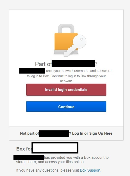

When attempting to log in to Box through SSO, a user receives an Invalid login credentials error after authenticating with their company identity provider (IdP).
This usually means authentication at the IdP succeeded, but Box could not match the identity in the SAML response to a valid managed user in the target Box enterprise.
