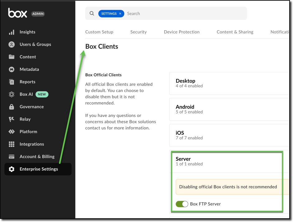

NOTE: Make sure you have FTP enabled for your account by going to the Admin Console (ask the admin of the enterprise), then going to Enterprise Settings > Box Clients > Server. Make sure "Box FTP Server" is enabled as shown below:

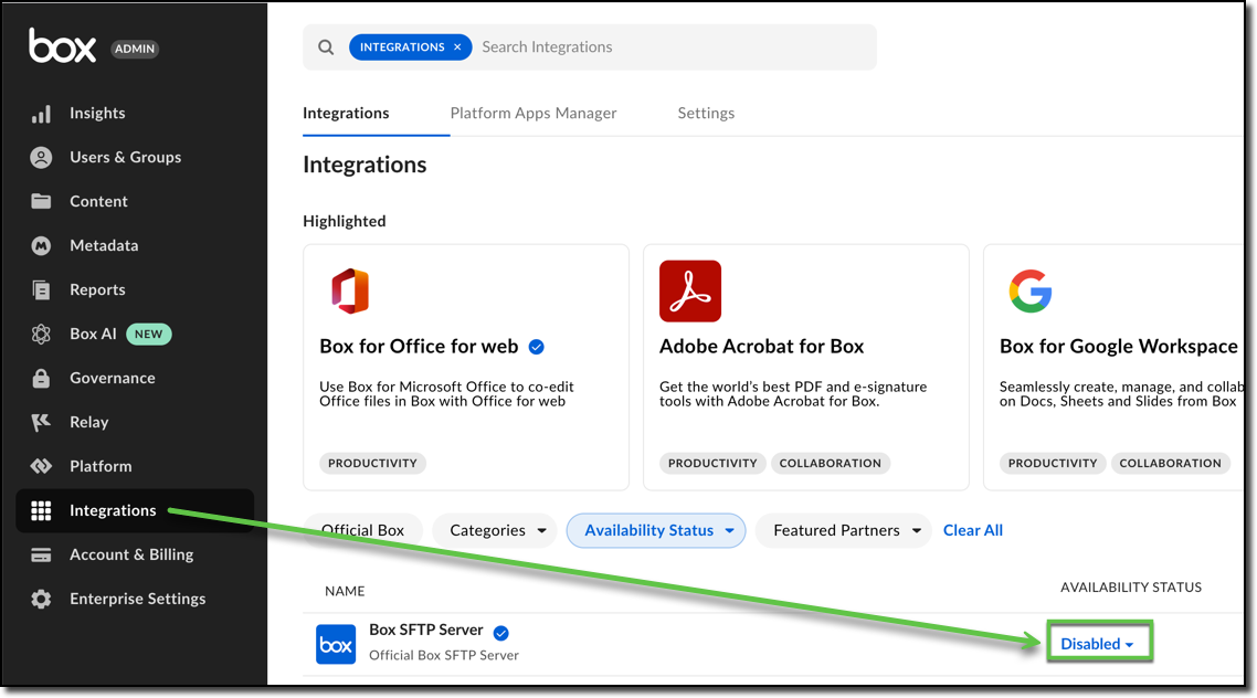

To enable SFTP for your account. Ask the administrator of your enterprise to go to Admin Console > Integrations > Box SFTP Server and enable it as shown below:
